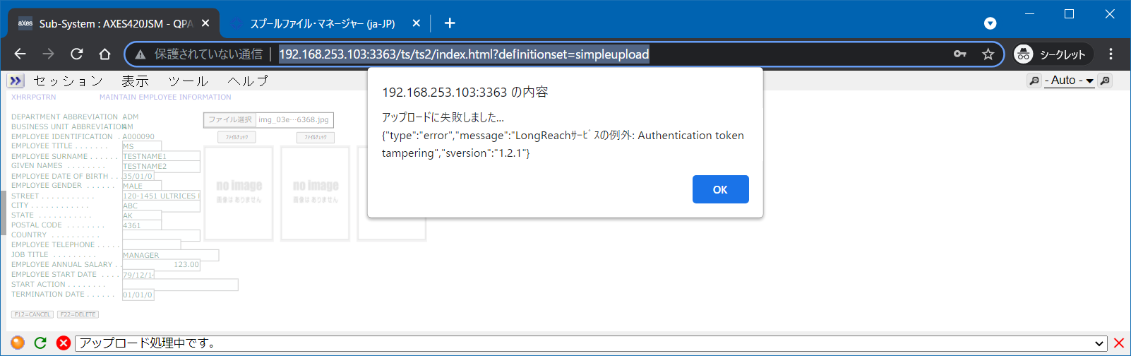

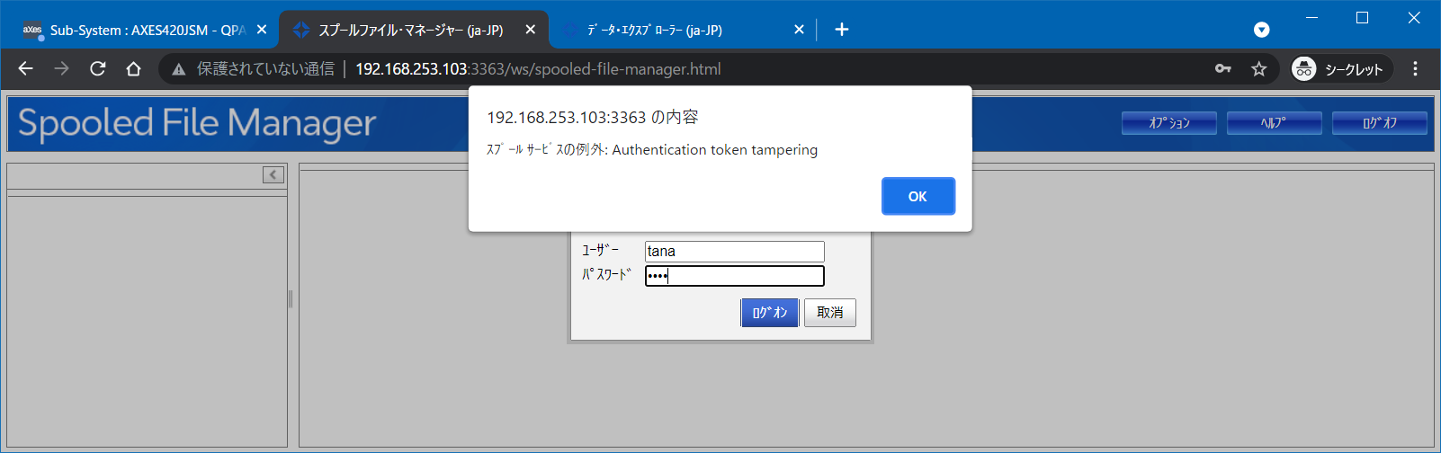

We are in trouble after applying the latest PTFs to V7R3M0 box. After that, file-uploading (using longreach service) and WS/DE was no longer available. As you can see from the following screenshots, "Authentication token tampering" appears in the error message.
When attempting uploaing a local file to IFS using longreach service.

When attemping signing onto to WS. (It happens to DE as well.)

All the PTFs were correctly applied. (I've asked about it to IBM Japan and still keeping in touch with them.)
Have anyone experienced/dealt this problem?? Need your help! m(__)m
