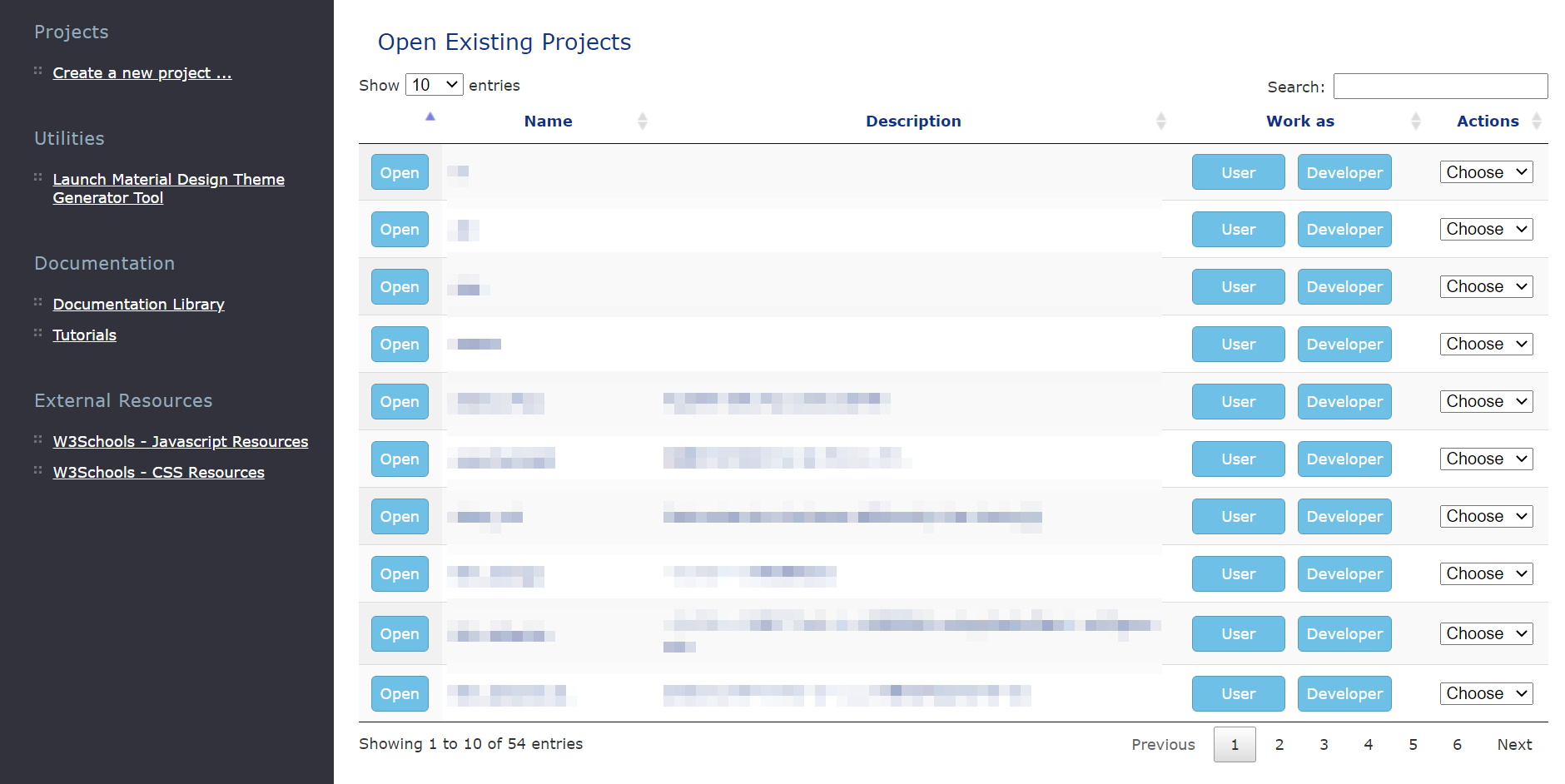

We encountered a problem that texts are not translated on the Open Existing Projects screen via the AWS API gateway.
Image 426.png (118.96 KiB) Viewed 33661 times
It hasspens to IE11, Edge(Chromium) and Chrome. (It is working OK on Firefox.)

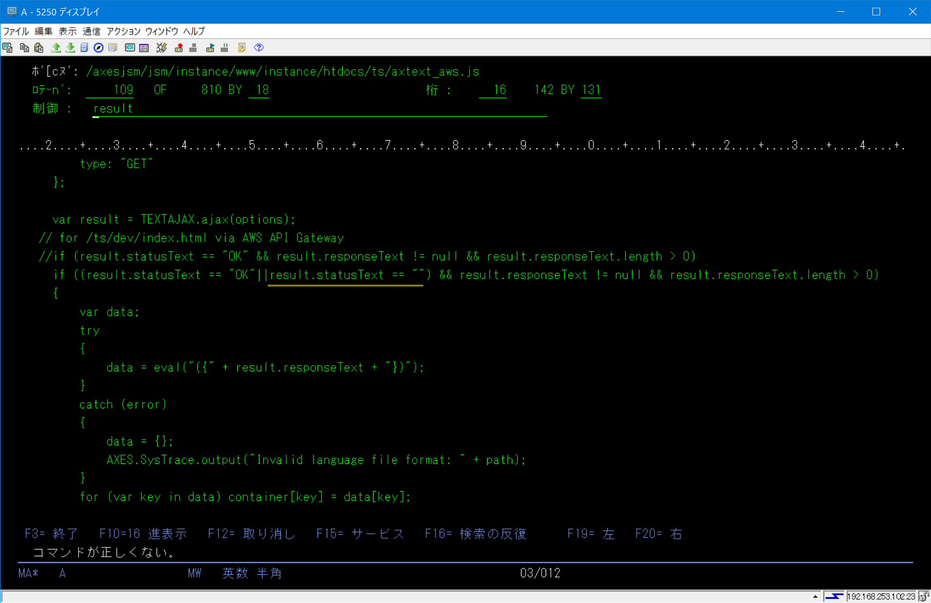

I don't know much about that API gateway, but found something I would like to share as follows.
When it's under the condition above, ajax transaction returns "blank" as its statusText in /ts/axtext.js. Even if it is "blank", its responseText contains the correct table data. Hence I changed the code for trial like the following screenshot.
Image 425.png (139.96 KiB) Viewed 33661 times
Then it went as expected.
