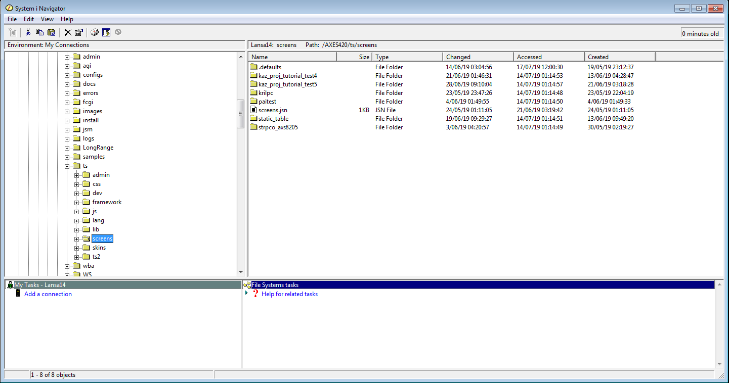

1. Open the IBM system i navigator and navigate to the project you want to copy. Typically in /AXES/TS/SCREENS

2. Right click and select copy
3. Navigate to the location you want to copy the project to. In this case, its aXes 4.2.0 so the location is as below
3.1 If you are using the aXes W3 webserver on aXes 4.2.0, typically /AXES420/TS/SCREENS
Screenshot from 2019-07-18 13-41-01.png (56.82 KiB) Viewed 32621 times
