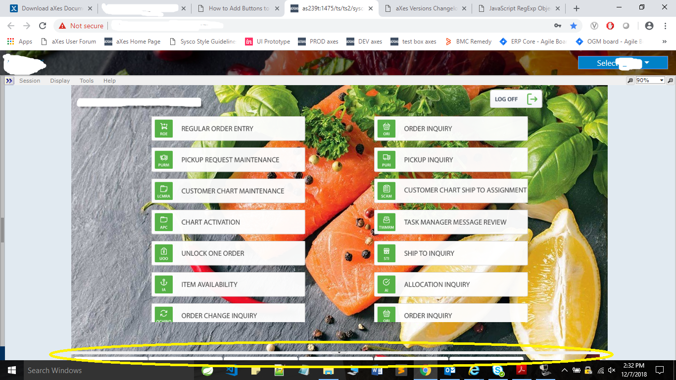

Why the function keys get disappears or half visible through out the pages ?
function key.png (1.19 MiB) Viewed 9248 times

HI Safal,
This is a support issue and you should be reporting this to LANSA Support together with a fiddler trace. Instructions on how to do this are available here:
viewtopic.php?f=10&t=51
I suspect this had something to do with any of the following:
- Your custom wrapper around the aXes terminal div
- The image in the background
- The terminal div is too large and the overflow is hidden as a consequence of the first point. Note how you cannot see the bottom of the terminal div containing the messages.
