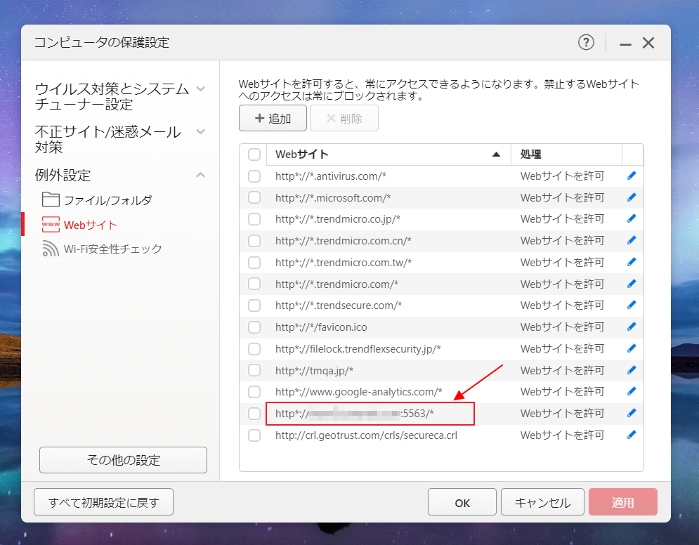

It looks like the attached screenshot and error message are not accessible at the moment, but I experienced a similar issue earlier.
After investigating, we found that Trend Micro’s Virus Buster “Real-Time Scan” feature was affecting JSM sessions.
We also confirmed that adding the AXES URL to the exception list for that feature prevents the sessions from being disconnected (see the figure below).
So you might want to check similar settings in your antivirus software.
Hope this helps.
