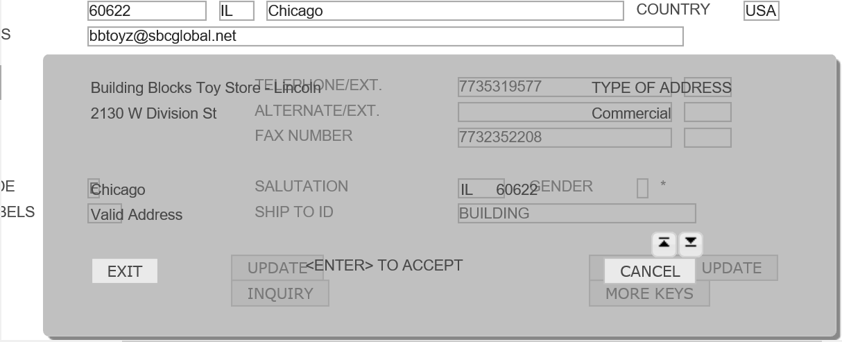

Transparent pop up window
5250 pop up windows are transparent so the screen behind is visible. I have tried a few things to correct this with no success
- Capture.PNG (44.63 KiB) Viewed 32150 times

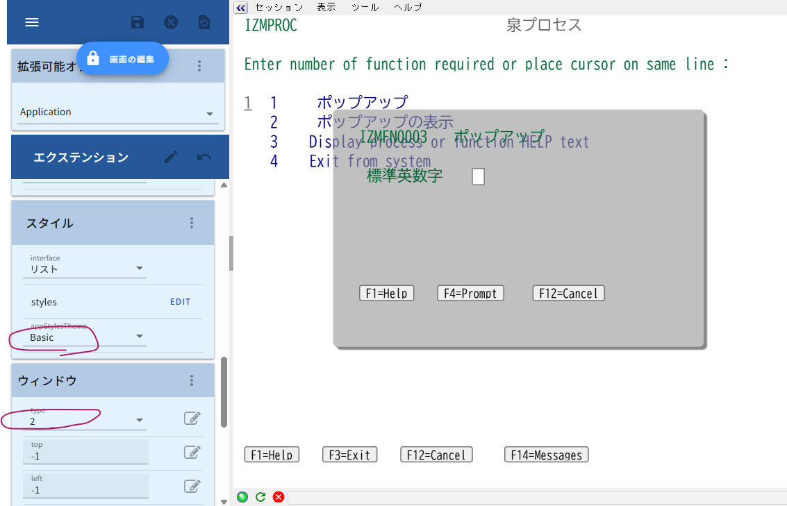

- Posts: 4
- Joined: 06 Oct 2017, 12:32
Re: Transparent pop up window
Hi All,
I found the same issue post in a previous version.
Is there a way to fix the same issue in v4.2.1?
Preferably I can fix this while keeping the style Basic.
- Posts: 128
- Joined: 24 Jul 2017, 17:02
Add the following Application.style to your project.
Or modifying /ts/ts2/css/*.css files as follows:
Hide from Fairdinkum
name...... optional (e.g., windowStyle)
styleFor... HTML Element
htmlTag... dummy, div.ax-terminal-window
style....... {
border: 1px solid #c9c9c9;
background-color: #fff;
