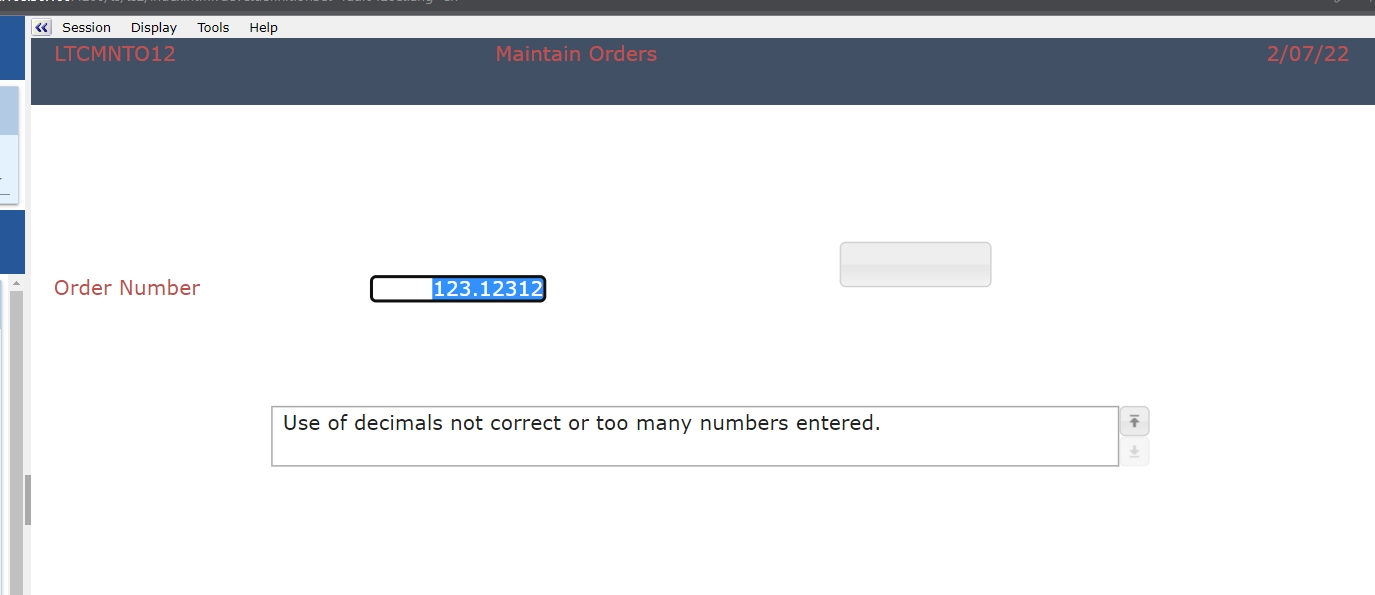

If you add an axMessageHandler extension in aXes to the screen, you can capture things like for example when a user enters a decimal point in a numeric field that doesnt support it:
adding a name to that extension, and addTerminalMsg check makes it available in the screen, but how can you capture the value inside that to use for something else? I tried FIELDS("Mensaje").getValue() but that didn't work, most likely because is not just one string, but an array... so, how can you capture that value?

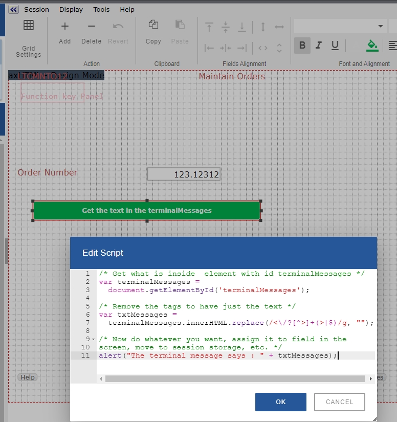

Well, I decided to go in a different direction to get this value. As the divs and different tags are already identified, if you see the source of the screen using the "developer tools" in the browser, you can see the names of everything, and this section is called "terminalMessages"
So a script like this, can retrieve what is inside that tag, but because in this case the text returns with an <option> tag around it, I just used a little replace regex to remove the tags from it.
/* Get what is inside  element with id terminalMessages */
var terminalMessages =
  document.getElementById('terminalMessages');
/* Remove the tags to have just the text */
var txtMessages =
  terminalMessages.innerHTML.replace(/<\/?[^>]+(>|$)/g, "");
/* Now do whatever you want, assign it to field in the
screen, move to session storage, etc. */
alert("The terminal message says : " + txtMessages);

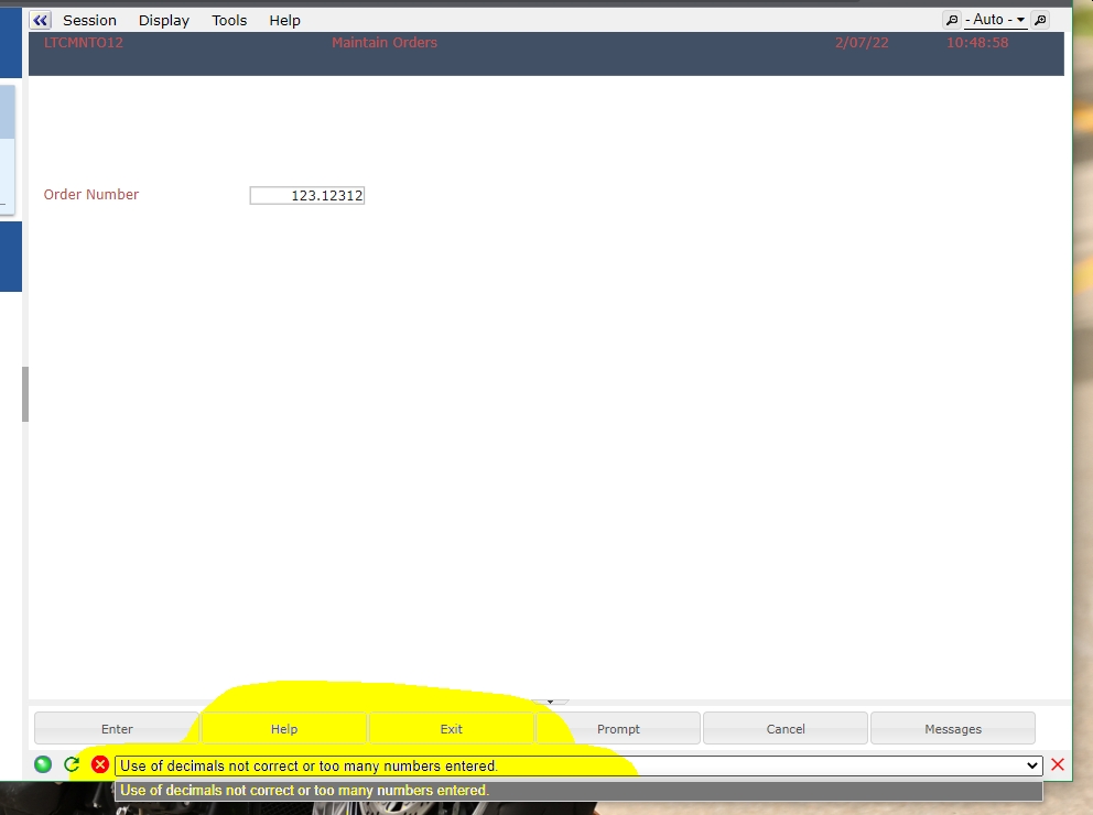

to get this final result:
