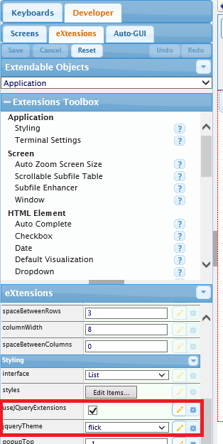

In axes 3.1.1 new jQuery themes are available for your project. You can choose a theme by selecting the application settings and turning on the jQuery themes option.
Set the useJQueryExtensions to true and choose your jQuery theme in the drop down below.

Axes has pre-installed a few themes which can be chosen from the Application settings. For this, you need to enable the jQuery first (in your application settings) and then all your eXtensions will automatically apply the theme selected, no need to assign the theme to each of them individually.
