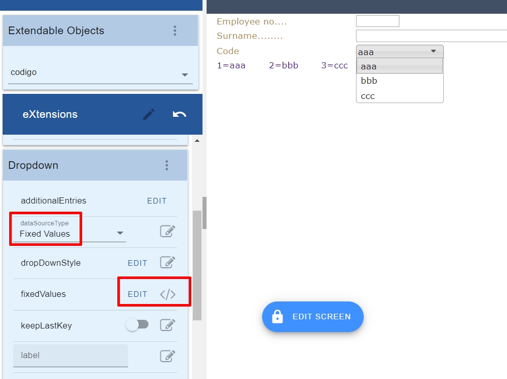

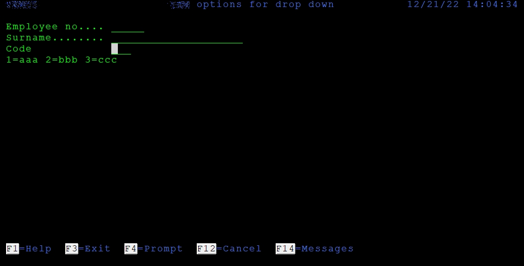

So, if you have a screen like this one:
and you want to have the input field code, to have a dropdown, using the values listed below, you could first identify the screen, also identify the field containing the 1=aaa 2=bbb etc for example as "options", then, bring a dropdown in the input field "code", leave the dropdown as Fixed Values, and select the script for fixedValues, click edit:
you can use this script there for example, which basically moves the string in the screen to an array, temporarly each entry is also split by the = character and the two halfs are used to populate value and text, adding entries to the returnValue array:
