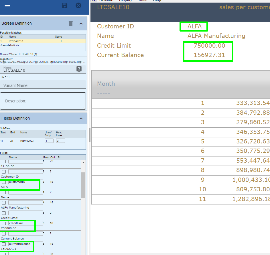

Let's say you have an screen like this one:
and you want to show a Pie Chart split between the balance and the available credit limit, and a column chart with the sales per month...
as you can see in the screen, you can calculate the available credit limit by a simple difference,
but not all the sales per the month are displayed because the subfile didn't fit in the screen.

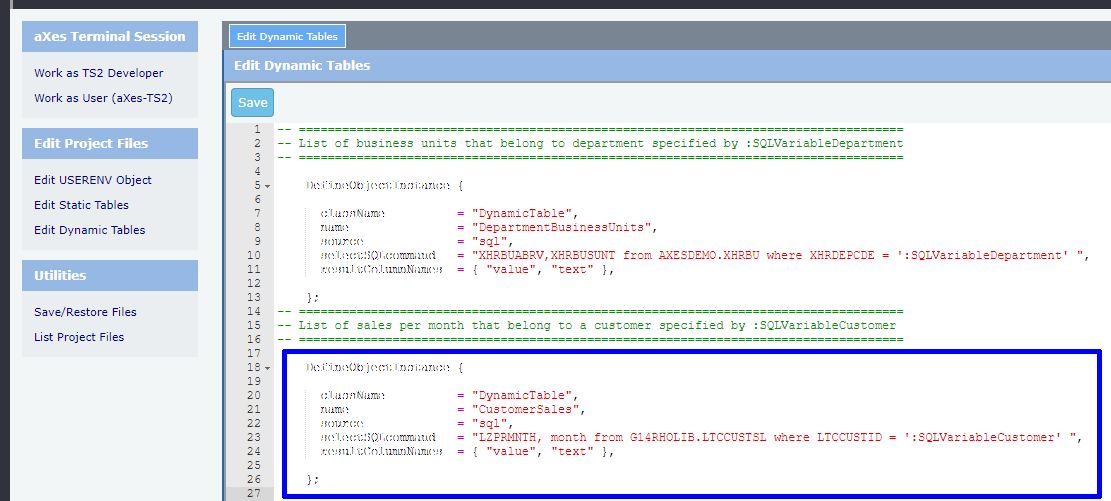

If you know what table, physical file is that one, then a simple solution is to create a "Dynamic Table",
which is just a sql query over that table and you can use a variable for example,
in this case the customer Id, to get the information you want. You define this "dynamic table"
at project level in aXes and be sure to restart your development session after that to see the changes:
the code for this dynamic table, or sql query over the table LTCCUSTSL in the library G14RHOLIB is complete here, notice the use of a variable i called SQLVariableCustomer and the control of which field I return as value, and which one as the text to display:
-- List of sales per month that belong to a customer specified by :SQLVariableCustomer
    DefineObjectInstance {
      className          = "DynamicTable",
      name               = "CustomerSales",
      source             = "sql",
      selectSQLcommand   = "LZPRMNTH, month from G14RHOLIB.LTCCUSTSL where LTCCUSTID = ':SQLVariableCustomer' ",
      resultColumnNames  = { "value", "text" },
With that in mind, I can go to aXes, identify the screen and the fields I want to access from the screen, like customerID, creditLimit and currentBalance (be very careful with lowercase and uppercase usage):
once you have done that, you can bring a couple of google chart extensions to the screen and add the next properties for the first graph:
