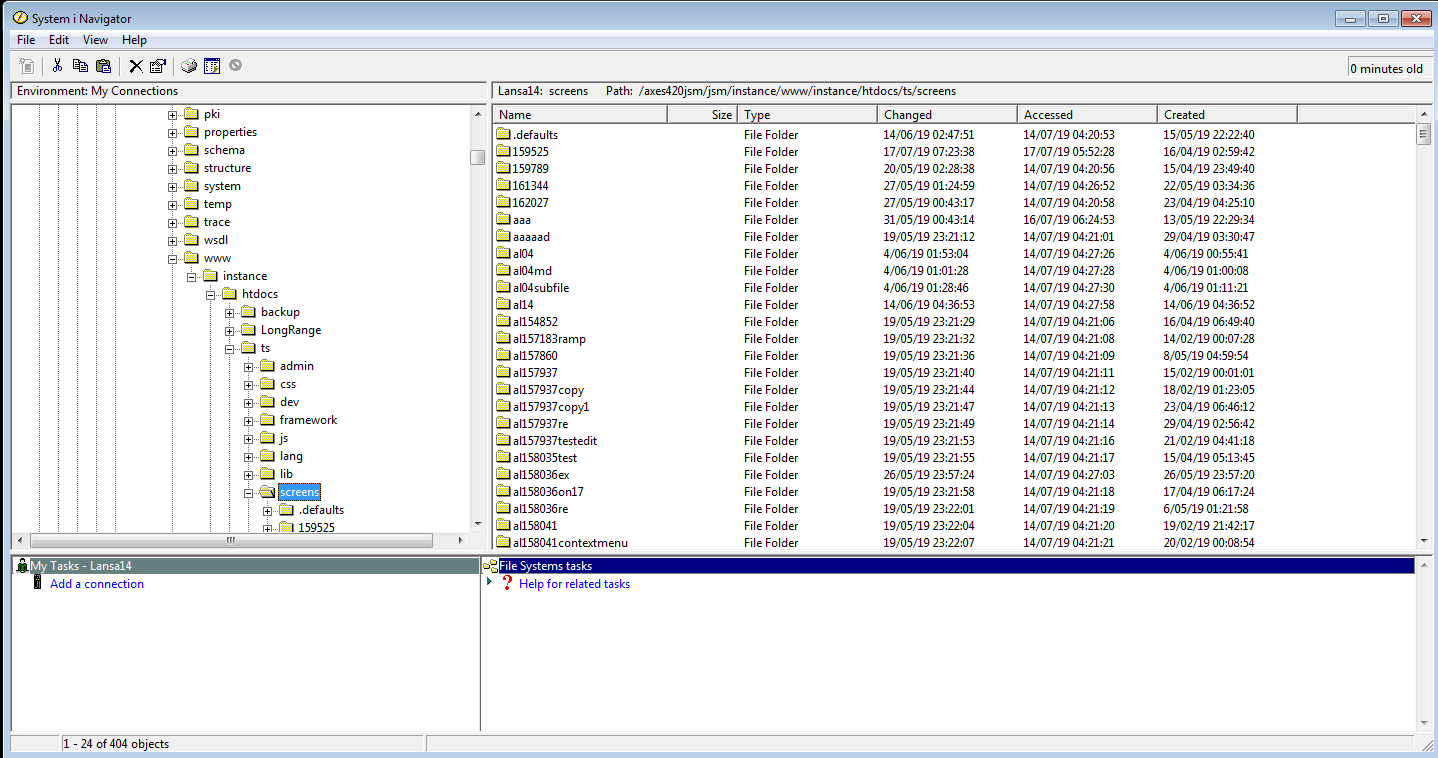

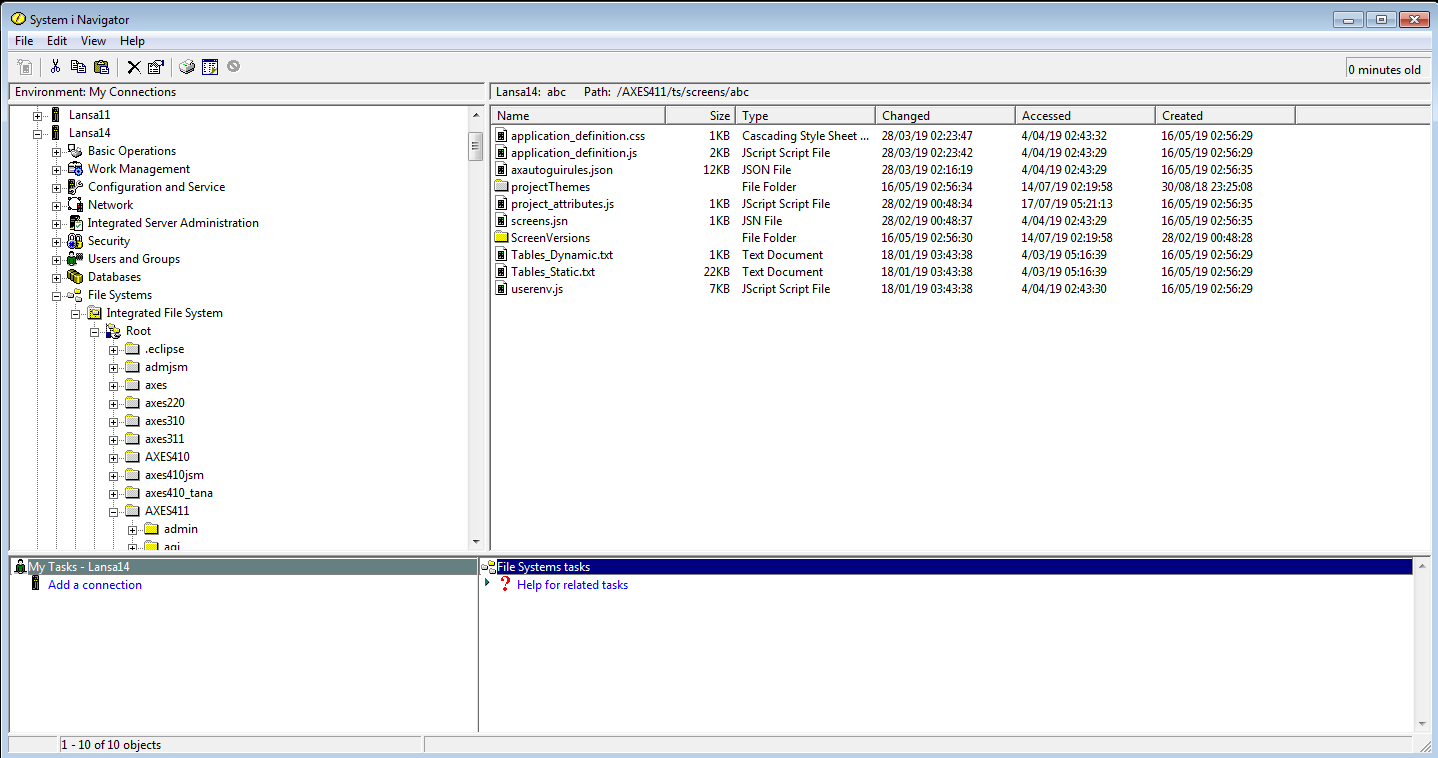

1. Open the IBM system i navigator and navigate to the project you want to copy. Typically in /AXES/TS/SCREENS
Screenshot from 2019-07-18 13-35-05.png (69.76 KiB) Viewed 32619 times
2. Right click and select copy

3.2 If you are using the aXes services HTTP webserver (Recommended) on aXes 4.2.0, typically /AXESJSM/JSM/INSTANCE/WWW/INSTANCE/HTDOCS/TS/SCREENS
Screenshot from 2019-07-18 13-42-23.png (90.91 KiB) Viewed 32619 times

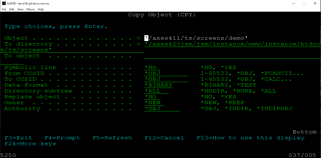

For this example we will be using a project in the folder /AXES411/TS/SCREENS to the folder /AXES420JSM/JSM/INSTANCE/WWW/INSTANCE/HTDOCS/TS/SCREENS
1) Login to the IBMi server and using the WRKLNK command navigate to the project you want to move.
2) select option 3 and then press F4
3) In the To Directory type in the directory to copy the project and in the Directory Subtree select *ALL
Screenshot from 2019-07-18 14-03-13.png (28.93 KiB) Viewed 32615 times
4) Press Enter and the project should be copied to the new location.
